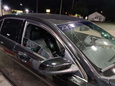

And lastly the car with numbers on it. Look close and you can begin to see the weight reduction LOL
