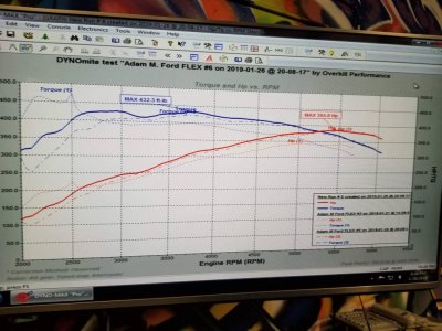

Here's some independent testing a week apart with stock turbos and fuel pump. Both near zero DA..... I would consider this "winter weather" LOL. The dotted line is with the stock intercooler. The two higher hp runs are heat soaked vs a 10 minute cooldown time... You can see the vehicle is much more happy with the intercooler. But by all means don't buy it. Keep the same mindset that has held this platform back for the last 8+ years.99e5f7cf2206ea16676c7f1e72191cc9

Define hot weather? Any tracks open in the dead of winter?

Look at the results I just posted.... If you aren't looking for maximum performance out of your tuned SHO/Flex then you don't need this. I've cleared a major hurdle for those who want to go faster. I see you like to shoot holes in any product that comes out for the platform by looking at your other posts. If you like the way Ford let it roll off the assembly line, by all means that's fine.... Just don't try to dump on performance mods for the rest of us please.

Jeff, I would gather, based upon results displayed, that EVERYONE can/would benefit from this upgrade.
I wouldn't relegate it's use to just those that track their cars specifically.
For instance, even in the midwest, where we see temp extremes from season to season, even those that drive their SHO's and get stuck in city traffic congestion etc. rather than having a heat soaked OEM IC from sitting in traffic, once it opens up, and say one wants to have a little spirited fun, then you can cuz of the much improved cooling properties of this new IC.
Even for those that motor year around (on the street only) particularly in hotter climates (the Texas, AZ. & Cali areas come to mind) they are going to reap benefits day in, day out.
Remember, these engines, and all of their ancillary parts seem to run hot by design. Which heat is never good. Especially excessive heat at that. Any ability, or opportunity one has available to bring temps down, across the board, is a tremendous thing.

Thanks. I was under the impression that in winter conditions it would not make that much of a difference. My bad.

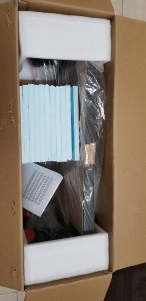

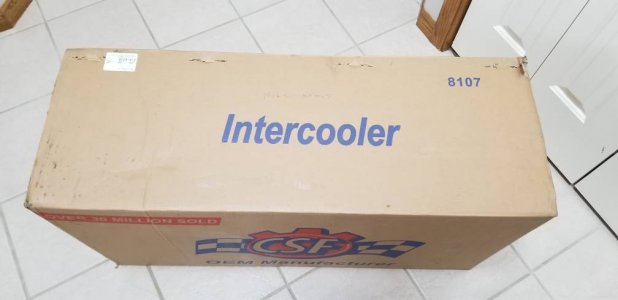

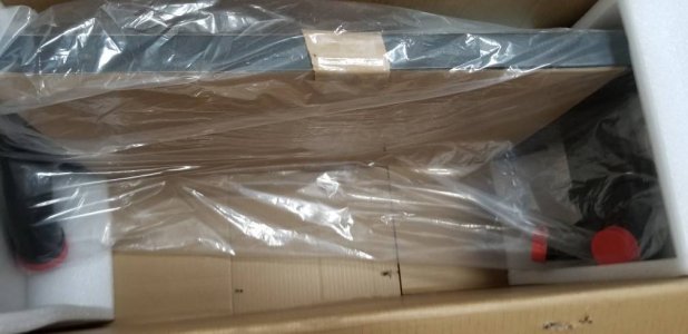

Mine was delivered last week.....
Although just like all the other upgraded, aftermarket performance parts I've been amassing over the last 6mo.'s, I really, really, REALLY need to find some time this Spring to get it all in, and then schedule me some dyno time at LMS yet again.
Even more fun times lie ahead!
Woot! Woot!
Thanks to Matt and all his crew over at Gearhead Tuning for investing the almost last 3yrs of their valuable time to making this become a reality for the entire platform!
Oh, and I should add, a full 2" inches thick, which is a vast improvement versus factory.
4739c50016b72f13daf8a72247ccbee3B72f05f6e3b77c94435f208c979403971f8911b956b684c3b9d71d884fa495b4A72d3fb67559d8e1e4f1734f82779487
Dang! Wish I lived closer to you and I'd be doing some porch thieving!! HA, kidding!
