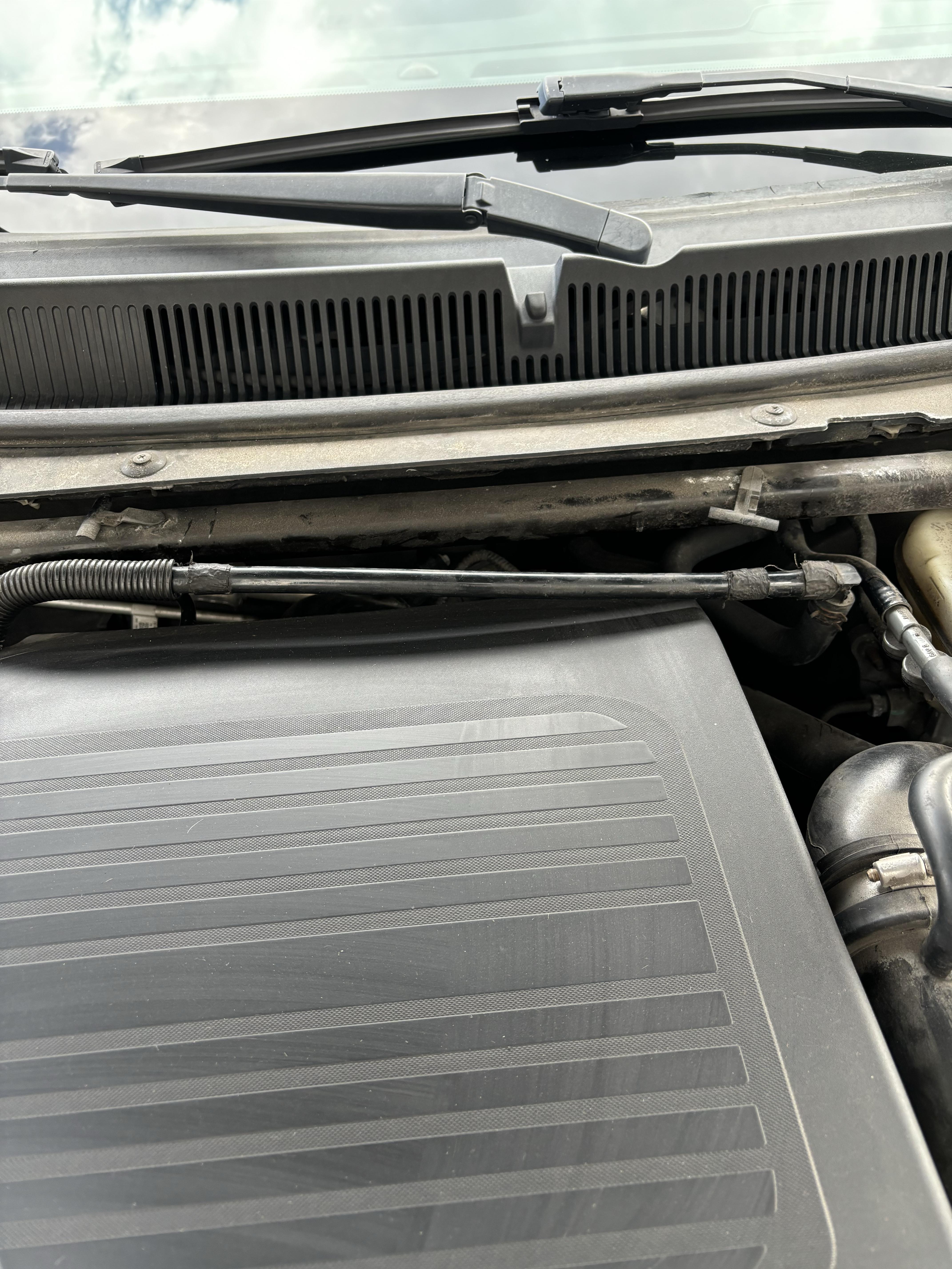

Anyone know the correct name of this or where I can locate some replacement parts for this system. I can hear/feel air coming from the 90 degree section on the right at idle. Honestly not sure what it is. First twin turboed car and my last turbocharged car was a 98 talon tsi that was vented to atmosphere so not sure what all connections these have to manage everything.

you are correct, Haynes and Chiltons both ignored the EB taurus, when I was looking at doing the oil pump in mine the only light I found was alldata, they have a consumer "DIY" level subscription now and its under $100 for various lengths of time. as for the random piece of vacuum tubing is it going to the brake booster? tascaparts.com is good about diagrams and part numbers, heres what I found, and heres the link: tascaparts.com / brake vacuum hose
1710503106792
If thats a bust I'd suggest a salvage yard, transverse 3.5L EB cars include:
2010-2019 Taurus SHO / Police Interceptor
2011-2019 Explorer Sport / Police Utility
2010-2019 Ford Flex AWD
2010-2019 Lincoln MKS
2010-2019 Lincoln MKT
The trucks, fullsize suvs, and vans all use longitudinal engine mounting so the vacuum system would be different.
