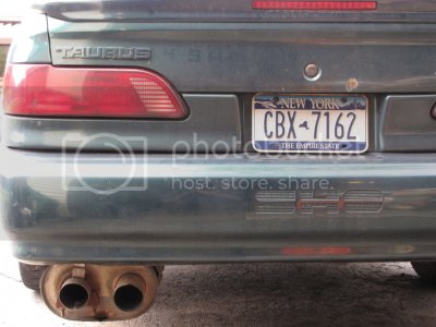

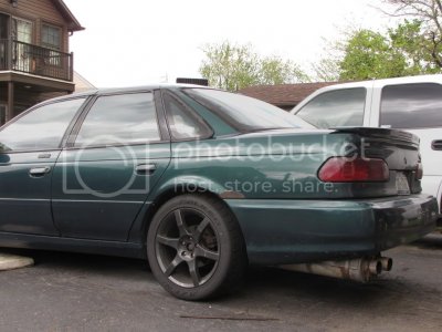

Im running 3 inch mendrel bends too , 2.5 at both Y. So far Borla is the *******. These are off a 2007 Mustang (shelby or GT500)
I also have a 18 inch ebay resonator that looks like a glasspack. Its loud but in the limit. Freeflow and quietness dont go well together. Ive also tried magnaflows but its even louder.
