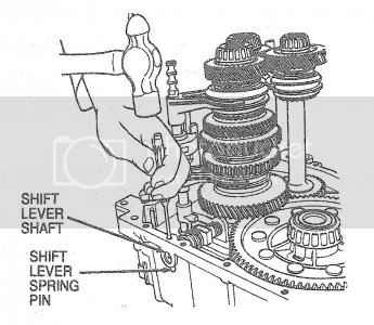

if looking at the trans from underneath the car, on the very bottom of the trans there is the end of a shaft, on mine its leaking a little bit.
I looked it up in the service manual and its called a shift shaft. Was just wondering on whats involved in replacing the seal.
Do I HAVE to take the trans apart?

You do have to take the trans case apart to change it. Once you do that seal is easy to replace. It's just a rubber o ring that slips over the shaft.

If you're talking about the shifter shaft seal with the metal that is used to attach the rubber boot.... Remove the boot and linkage, use some pliers and pull on the seal (metal). Make sure the shaft is smooth before sliding on the new lubbed rubber..... seal and carefully tap it in.
It's been a few years since I replaced mine myself and I think Gary replaced mine when he rebuilt my transmission 2 years ago.
EDIT: I couldn't see the picture at work. I was thinking about a different seal.
