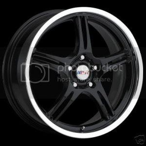

I have found a really nice wheel in the 5x108 40mm offset and think I am going to order them and some tires. These wheels will be 17x7.5, the suggested tire size is 225/50/17. This tire size is also the same size suggested with a 17x7 wheel. Why would the same tire be suggested for wheels that have a different width by .5 of an inch?

On a 7.5" I'd probably run a 235/45/17.
If I could afford new wheels & tires. Which I can't. :p
Good lookin' wheel.

Hey Marty.. the rims I have on my car right now (summer rims) look almost exactly like the ones you are getting, except mine are 18's.
Let me know if you would like pictures, if you don't know what they look like on a gen3 yet.

Let me know if they are available please, If you order them. Thats the wheel my dad wants for his SHO.
