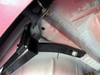

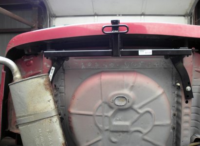

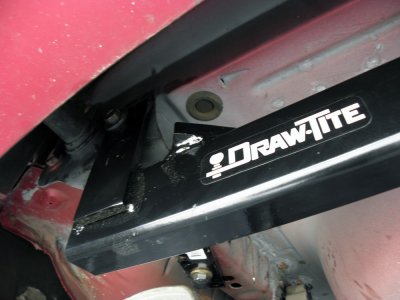

Check out the way they mount trailer hitches on the back. You'll have to do all the fab work, mount it to the bumper shocks but not to the body and then cut holes in the bumper cover as needed.
Taurushitch01
Taurushitch02
Taurushitch03
