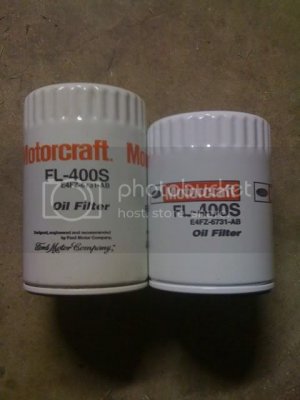

IMG 0053

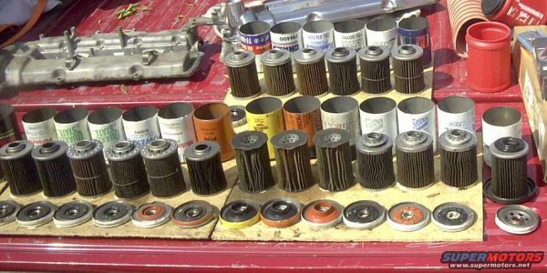

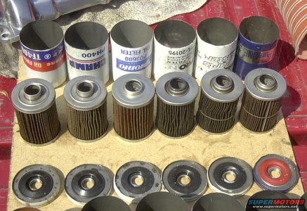

The 400-S looks more like the Purolator Blue ones, still not identical inside though.
Oil filters cut up
Oil filters cut up 5
