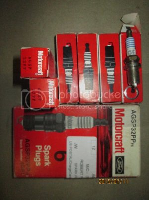

Greensales has 716 formerly rare NOS Motorcraft AGSP32PP spark plugs. I bought 12; $4.00 each. Very nice folks to deal with and shipping was reasonable. Phone works better than email. I'm tempted to be selfish and buy them all, but I'm not that kind of guy and I hope others on here will not scarf them up to profit on either. 716 should keep the SHO community going for a while:). I can't imagine what corner of what dusty warehouse has had them all these years.
BTW, they also have the original rear control arm knuckle-end bolts.
AGSP32PP
