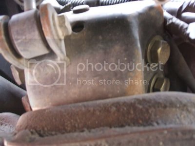

I plan on reinforcing my own mounts. I've been spending too much money, if I can save some I need to.
I'm going to drill and put bolts through them and bushings. I bought es sway bar bushings. Should I install four bolts on the front mount and bushings on both sides of the bolt? I'm not sure if there's enough room to fit two per bolt.
On the rear would two bolts be good enough? thank you

check this forum . you gotta buy a two part epoxy to fill that mount up. or maybe sho times. it cost 45.. my mount is better than the ones they sell for 125. you dont need the busings just two grade 8 bolts

I already bought the end link bushings. I thought I read people just use the bushings and bolts. I was considering buying the epoxy, but I thought four bolts with bushings would be good on the front.

Just drill in the center and use one bolt. No bushing needed on the inside; one there may interfere with the limiter rod. Remove the wimpy limiter rod, enlarge the holes and replace with a larger bolt. If you happen to have a welder, weld the bolt in place for added strength, but that is not required.
The filler material is urethane, not epoxy. I did mine that way. The resulting mount is very stiff, definitely suitable for a track car but more noise and vibration than I would prefer for a street car.

My front mount must've been bad for long before I got the car. The mount was completely shot. I'm glad I didn't buy a reinforced mount because I wouldn't have been able to turn this one in for a core. On the bottom of the mount where the stud is it's rusted through, it's not that bad, but I was not happy to see that. I'm going to have it welded, it's only maybe an inch long. I used four bolts and metal lock nuts for the front mount with poly bushings. I'm going to use two on the rear and one on the trans. I removed the limiting rod for the front.

Were you planning on replacing the limiting rod with a hardened 1/2" bolt? It would probably be a good idea. It is my understanding that if the motor mount fails the limiting rod is what keeps it from completely seperating. I would think that not having it there at all could be a saftey issue.

I know you are just trying to help, but I guess you don't understand what I did to reinforce the mount. I used four grade 8 bolts, I put polyurethane bushings on the bottom side of the bolts and I used grade 8 flanged metal lock nuts, not nylon. Those bolts aren't going anywhere. Even if the bushings failed the bolts would still be there, so the mount wouldn't be able to come apart.
