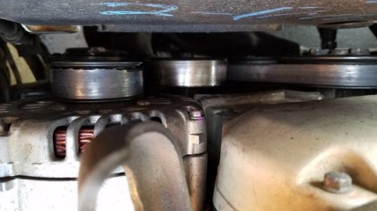

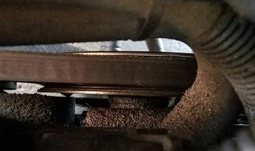

The pulley on my power steering pump seems to be misaligned. It works fine as far as I can tell but it's about one rib too far over. I've had a history of pulley problems and it's shredded a couple of belts. The last time I left the belt with a rib shaved and the squeaking has gone away once it settled into its current position.
Wmdv0LKl
6fQDYQMl
As you can see, the belt is one rib over on the power steering pump. Any idea what would cause this or how to fix it?
13,265
On my GenIII I had a similar issue and the crank pulley was the issue as it is a 2 piece pulley that is press fit together that can separate. They (ps pulley) can also get twisted as mentioned above, or any other misalignment in the belt path can make fitment off.

Thanks. Everything else lines up correctly. I will try to check the pulley while I'm in there.
