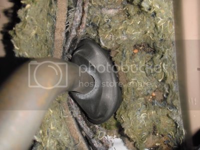

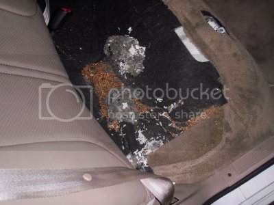

I am storing my car at my house in AZ while I am working in CA. So, when I read this post I needed to check on the '91 and my worst fears were true! Those little fuXX'ers! Yep, a nest under the rear seat and next to the gearshift. I put traps all around the outside of the car and peppermint inside. It looks like they are storing food. The food is from the palm tree in the front yard. Luckily, no visible damage. They did eat that paper under the rear seat. What was that? Was it important?
