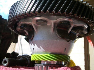

It would take an act of God to eject one of my diff pins.
Tn CIMG1546
But yeah, I'm starting to wonder if that's not what it is. Either way, I'll part it out before I pull the transmission again. There was a fair amount of silver badness in the outgoing fluid. :(
