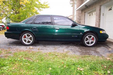

Team Dynamics Pro Race II 17x7 Chrome wheel pics. This wheel weighs 18.1 lb with the chrome plating and 17.25 without. It’s lighter than a 16x6 slicer.
On a (dirty) car with TCE SHO Stopper Jr. front (DP calipers – sealed), and 11.6” rear kit.
PRII 17x7 chrome
PRII 17x7 chrome TCE Jr DP fronts
PRII 17x7 chrome TCE Jr DP fronts 2
PRII 17x7 chrome 11 6 rears

what sixe are the tires and rims? 16*7 with 225/50R16 ? they should fit fine on my wagon.
SHO NUT
Apr 18, 2003
711
186
Ingleside
235/45R17 on 17x7 with 45 mm offset. See the side of the tire for the tire size ;)
The 45 mm offset with the 235 tire width tucks the tire in as far as reasonably possible before it hits the strut. Thus they give the maximum fender-to-tire clearance possible (and probably fit the wagon).

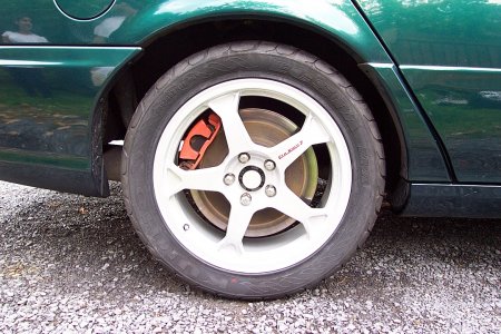

New, they are:
Wheels $1,140 delivered (new non-chrome would be $700 delivered)
Tires $546 delivered
Total $1,686
The higher the (positive) offset, the more the wheel moves inward, and the closer the spokes get to the calipers. You actually want less positive offset to clear big brakes. The 45 mm offset units shown needed a small spacer in the front to clear the DP calipers. Depending on what SHO Stopper kit you have, 50 may or may not fit. We have both SHO Stopper kits here on cars, if you are serious and want fitment tested on the Sr. kit.
