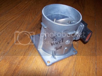

found me a nice 1995 80mm Mark VIII MAF, time to send the chip to be burned:)

sweet. that means you doint have to cut and splice your maf connector it should plug right in.
