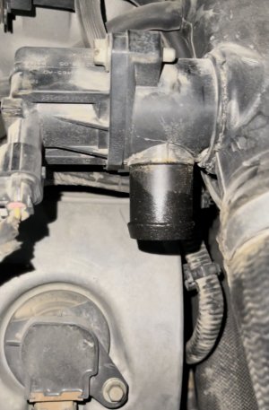

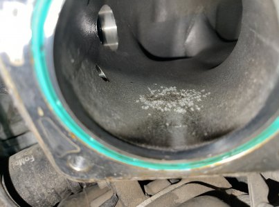

I cleaned the throttle body and MAP sensors with their appropriate spray cleaners. So far, I've noticed an mpg improvement of around 3-4 mostly on the highway; mpg in the city hasn't improved much. The improvement is nothing significant but noteworthy considering it's an easy clean. Acceleration has definitely improved, however. I'm going to look into O2 sensors, injectors, and fuel trim next.
I also noticed a couple of things during the cleaning.
First, there appeared to be these scratch marks on the intake manifold right behind the throttle body. I'm not sure what could have caused that, I hope someone can elaborate.
Second, I noticed a black oily residue covering the bottom of the intake pipe as well as the first MAP sensor. I also did the BOV mod a while ago and noticed some oil on the BOV as well. Is this normal?

Without a catch can installed , oil is normal everywhere you see it. Oil outside of intake pipe, no that's not normal, and could be a spot for a boost leak and from picture I can't tell if it's shadow or you have residue under pipe on valve cover and if that's the case, ide replace that pipe ASAP. Inside intake pipe oil is normal, again without a catch can on Ecoboost engine, reason why you will get buildup on valves. The scratches , as a process engineer that looks like an imperfection from the cast process,foreign material or just a issue with mold, not enough that QT wouldn't pass it. Or possibly spotting from a carb spray at one point. I suggest and upgrade to EPP pipes and get a catch can, there reasonable, easy to maintain once installed. New plugs, O2s, reset KAM or leave battery disconnected during tune up, which should give enough time to drain everything and do a relearn. Hope this helps.

Yeah that helps a lot, thank you. And yes, there is a residue under the intake pipe on the valve cover. What could be causing a boost leak in this scenario? Worn/cracked pipes?

Yes they are and are installed on mine, biggest trick is patience to make sure you have them all fitted and secured. When I did front turbo I removed intake to that turbo and made install of charge pipe/hose easier, plus as a bonus I found the intake to front loose. And glad I did the job, when I removed pipe from rear to intercooler, it was oily at a seam. These OEM pipes are just brittle junk, especially when you add power. Oily residue at intake, could be loose clamp or you have a crack in the plastic seam. Honest ide replace all charge pipes. Best of luck to ya.

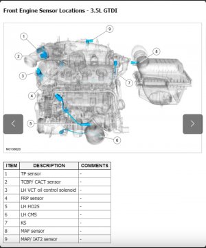

Ok, another post had the sensor at #2 called a MAP sensor as well as the one at #9. Still getting used to all of these different acronyms. I just cleaned the sensor at #9 last night to see if it helps with the shuddering at idle for a few minutes at cold start and to help with mpgs.
