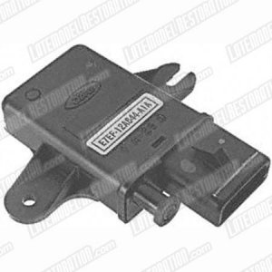

Typical MAP sensor (note the hose on the ******):
51 ford aerostar map sensor part number e43f 9f479

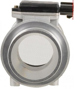

Typical MAF sensor:
869502 01
So, which one are you talking about?

Ok. Thanks for clarifying that Ruso. It's the MAF sensor, which is the last pictures. That's what I changed because I thought it was faulty.

You need to use an OEM Ford SHO 55 mm MAF; aftermarket onjes wont just bolt on and work, and unless your engine is highly modded, the stock MAF will work best. IF you still have the old one, it may just need to have the filament cleaned with electronics cleaner, as they rarely go bad. WHy did you think it was bad ?

+1 on the cleaning.
I have a K&N filter, and I need to clean my MAF at least once every summer. Oil from the filter get stuck onto the filament of the sensor. It does make a difference.
