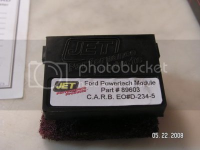

the chip is burned for a 94 Crown Vic 4.6
thats what the part number cross references too on summitracing.com
this is a random image I found on the web, it sort of looks like this

Don't know still. We could give it a try but that one might be beyond what we can do.
