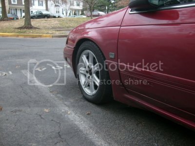

Intrax w/ 1 dead-coil cut up front...
(sorry for the small pix, cardomain is down)
