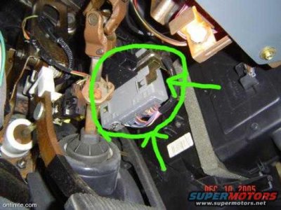

Cylinder is R&R. Where is the PATS comp. located. I havent looked real well but thought Id ask you before I waste too much time pulling panels trying to find it... Thanks again ...
Thanks for all the help I did as Brian mentioned and R&R the cyl and key.. here is the rundown for any future SHO nuts that have this prob... Dealer said 300$ to R&R. Locksmith in my area said 140 and he could cut and program a key for me without the orig. I however took the less expensive route at a whopping 25$ from good ole ebay thanks to Brian (my many thanks) The cyl was easy to drill out it took a 15mm bit I forget the sae measure but this bit was the perfect size to drill out the cyl. tumblers I started with a 11mm bit and it was just a little too small and missed the tumblers but the larger size cut out the cyl. exact then just pick out the brass tumblers. First, if you dont have a key pull the black plastic key guard off of the cyl. with a pair of pliers (dont pry off as mentioned by Brian). Second, remove the cover by 3 phillips (crosspoint) screws and pull it apart with your hands no other tools required or recommended. Third, remove the black ring around the cyl. this is the transponder reader as mentioned by brian so dont break it, now remove the black clip that was behind the ring now just drill out the cylinder making sure to stay in the middle where the key goes in drill back no further than 1.5 in no more. Now all you have to do is use a small flat screwdriver or dental tools and pick out the brass tumblers. Once you get them out the inner part of the cyl. will turn and once you have turned it all the way forward bring it back 1/16th turn and press in the release at the bottom of the cyl small hole in the middle of the cyl. with a small screwdriver and just pull out the old cyl.

Bizzy
May 1, 2001
13,222
1,462
I think the PATS module is up under the kick panel under the steering column. Key words....I think. :) Someone please correct me if I'm wrong.
SHOZ123
Dec 2, 2000
12,152
673
Illinois
Here's where to find the code. Sometimes furd saw fit to put some tape over the sticker though....
Keyless entry code location gen 3
