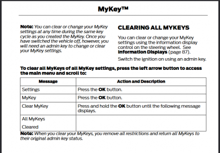

Found out about the my key function but I forgot to set it up to have my lane keep assist. How do I go about removing the settings from the key? I have placed it back in the slot in the console but it’s not showing any options to reset or configure the key. I have a second key I heard both keys needed to be in the vehicle to reset it. I had no luck, I placed second key in slot and no my key configuration options presented like the first key or anything.. What am I doing wrong?

It's in the owners manual. Not knowing what year you have, this is for 2016.
