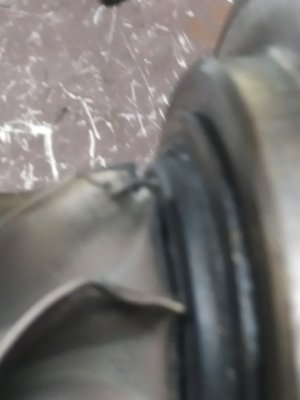

Thank you for your reply. One turbo had fin damage. Picture included. Sorry for the low quality. The other he said was seized when he was inspecting it.
I will add the water pump, timing chain and related parts to the list.
