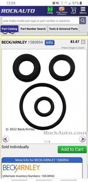

My fuel injectors are leaking like crazy and I can't find the iring kit anywhere. I have a 94 Ford Taurus SHO 3.2. if anyone can give me a link if appreciate it very much. Thanks

This is what you want.
You can also find kits that will work at the parts store by having them look up old Toyota vehicles. I can't remember which ones but it shouldn't be that hard to match up.

If you need them faster you can go to the local parts store and have them look up an early 90s Toyota pickup with a 3.0.
Same kit used on the SHO except you won't use the larger o-ring. Everything else is identical.
