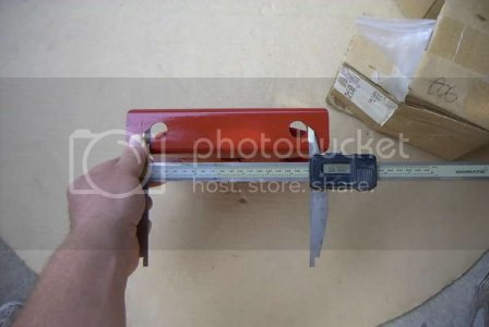

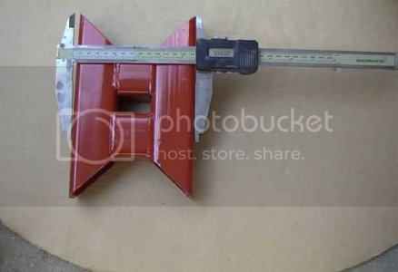

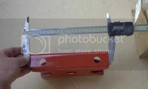

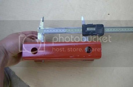

Here you go. I didn't locate the holes, I justed marked them after I put the brace up into place and drilled accordingly.
