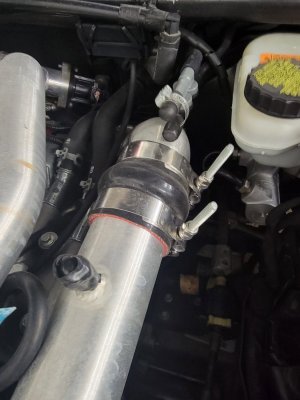

This is how I solved it.
did you just block it off completely ? lol
so i found a forum page with a guy having similar issues, check his last post in the thread and let me know if you think this could be my problem as well. if so ill buy the sensor, all the gaskets and try cleaning the intake valves once i figure out how.
Yep
