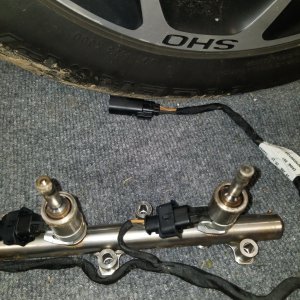

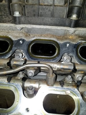

Jecters is easy son just yank off that intake manifold and them jecter rails is only a couple bolts come right off real nice ya hear get yerself a whole rail o jecters easy clean yerself some valves too

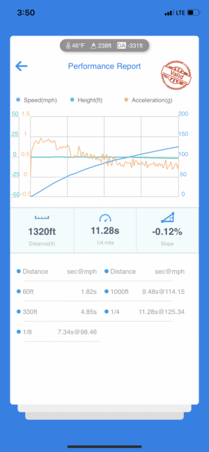

The XDI injectors made a big difference for me during the short period I used them. I ran a crazy time on the street with no nitrous using the XDI injectors. 11.28. Previously I’d need a 75 shot of nitrous to do that, on a prepped drag strip nonetheless. I’d say I’ll never use stock injectors again. IMG 3041
