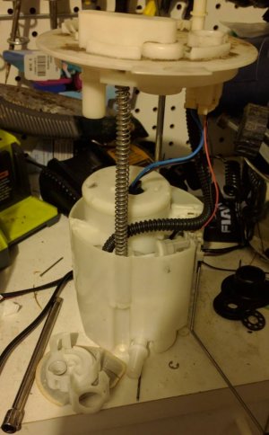

Hard to believe that the fuel filter is now a lifetime unit??
No way to change it except with a fuel pump replacement?
Anybody change one yet?

I have changed the fuel pump on mine... Super easy! The biggest PIA is getting the locking ring off... There is a tool that makes it easier but it's an expensive tool just to use once.
You can get access to the fuel pump by removing the lower part of the rear seat. The pump is on the passenger side.
