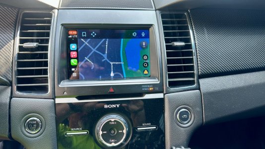

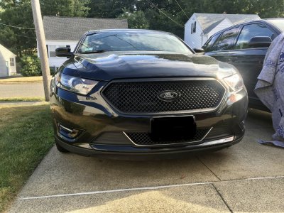

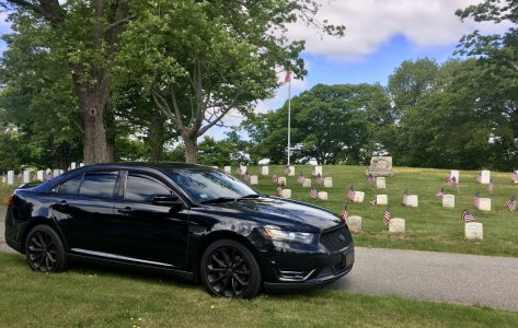

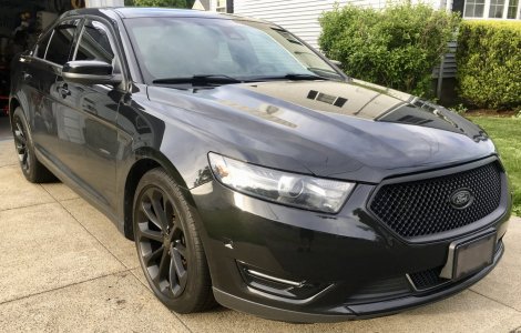

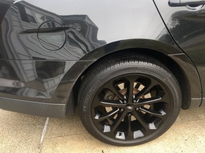

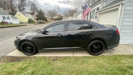

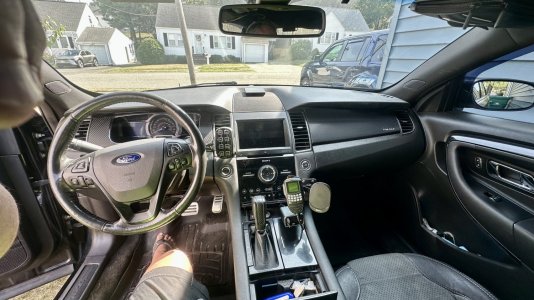

Unfortunately my 2014 SHO non-PP w/ 138000 miles has to go. I love the car, it has been my daily for the past 9 years. I added a catch can, cold air intake, and a noice make delete. I didn’t tune it but added some stuff to help make it last. I replaced the radio with and updated sync 3 with wireless CarPlay. I had to replace both turbos in January 2025 at the cost of $6400. Both fuel pumps were replaced in July 2025 for $1500. Now I’m told the computer is junked. Working on getting that replaced now. Never had PTU issues still runs strong. The engine purrs when the fuel gets to it. Maintenance was always done ahead of schedule and with full synthetic and motorcraft parts when available. The paint unfortunately appears that the clear coat met its match with the sun. Don’t know if previous owner had a cheap repair job done from an unreported incident but it drives me crazy when I look at it. I always got compliments on how great the Tuxedo Black looks when it was freshly washed. Plus, I blacked out all the chrome. I’m gonna miss it after it’s fixed.
