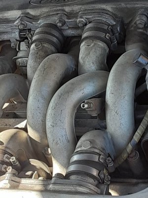

Where is the positive intake vaccum hose located on a 1992 Ford engine. The previous owner said it's a rebuilt engine when I bought this car.
There is an unknown port on top of the engine, but I don't think that's it. For pic, text me 8586635279 or email ([email protected])

Port on top may be it because the hose of AT-100 Intake Blast visually looks like it will connect to my engine.

You sure that's not a schrader valve for the fuel rail? Been a while since I actually looked at mine but I thought they sat more upright.

That’s the fuel rail Schraeder valve. There is a small port on back side of intake toward firewall, the one used for the secondary canister, a larger vac line pointed toward pass. side, a small inside port just above alternator that provides vac for fuel pressure diaphragm.
