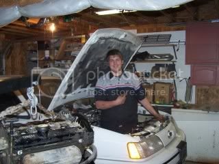

You took the engine out without taking the hood off? So much easier to get at stuff with it off.
Post lots of pictures! Painted and cleaned up SHO engines look awesome.

The hood is wired up out of the way, it was far from in the way. I'll be putting it outside soon, and I didn't want to mess with that heavy ass hood.
