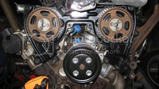

This is entirely true, yes grinding off the egr stuff will gain you some much needed space but i did this recently and discovered that the coupler will contact without a spacer.
IMG 0515
This picture the 1/8 spacers are in place.
