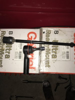

The original question is regarding the outer tie rod ends, however are there variances in the inners or outers between years? (I assume differences for ATX to MTX, this is an MTX). I just looked at the one from SHOsource, the one I got has a polyurethane flexible boot, but the other option looked similar to that on the SHOsource website. I’ll post a pic of my hardware on this thread in a second.
