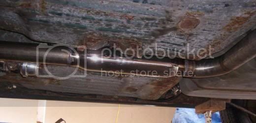

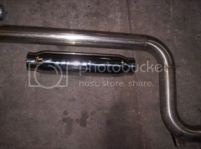

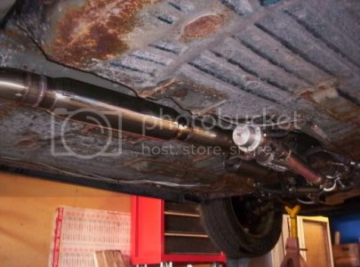

I guess it has something to do with large tubing exhaust pipes and relatively small engines (3" on a 3.2L), But I had the horrible 'import buzz' in the mid-range.
you simply can't be taken seriously if you ride makes this sound.
the fix, to get a resonator, but no ordinary resonator will do for my car. I need one that cost alot of money for little return (I have a theme going here).
roughly $94.45 later I have one that's a metallurgical match to the rest of the exhaust system (304) and it welded up. it does sound less high-strung and more deep/mellow. Enjoy!

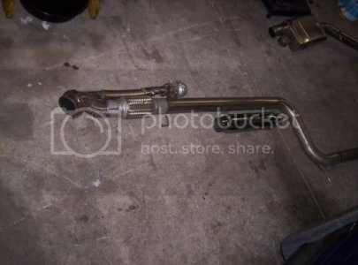

1.Thats a nice looking exhaust setup, I particularly like the clean bends.
2. What in gods name is that bell thingy shooting out next to your flexpipe.
3. Is your setup catless?

that would be his WG for the turbo setup he is running. I believe...
Slick- what muffler is that? chambered? Straight through?

yes, it's as wastegate actuator. thats a chambered MAC flowpath it's OK, it muffles alright, just needs a resonator to go with it. I have the FP744 in stainless

I'm really surprised how much more quiet the car is now. this resonator is really good, it's just as much muffler as resonator judging by how much it reduces noise. nice, deep tone as well.
