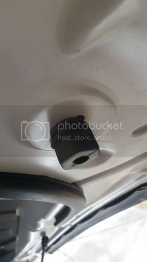

"turned out" would be extending them outward, & thus in turn, raise the hood.
If the OP is desiring to make the hood "tighter" (or closer) to engine bay/front fenders, latch, etc. then you'd want to recess, depress, or turn them inwards, in order to lower the hood.
Great pic btw.

Just saying because mine was shaking on the highway. I turned mine out putting more up pressure on the latch and solving my problem. I have not been at the high speeds stated above but if I did I would feel more conformable with hood pins like yours. I have been at highway speeds when a hood folds over. Scarry, dangerous and created a considerable amount of damage.

+1 to this. I was riding with my parents in their truck on the interstate at 75 mph and the hood was flopping up and down as if it wasn't latched and was ready to fly open (if not for the safety latch). Once we got home I looked at the hood and it was pretty obvious the hood stops were too far in and it allowed the hood move around. Turning them out tightened up the hood and held it firmly.
Granted, one needs to really know the problem the OP was facing. It could be a situation where the stops are too far in so it allows too much movement. It could also be a situation where the stops are too far out so it doesn't allow the hood latch to completely latch. Either way, I would start by investigating how the hood sits when stopped and look at the stops.
