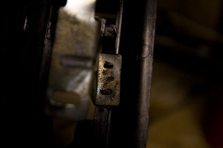

3. With the sandpaper, clean off the surface of the metal brackets, and clean up the mating surfaces of the roof console as well.

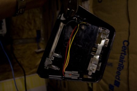

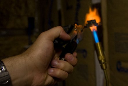

4. For the front bracket, clamp it on the section where the screw is supposed to go through and heat up the opposite side that is supposed to be mated to the roof console.
5. Once it is red, carefully place it on the mating surface of the plasic and push it in a bit. Within a second the plastic will heat up and give way before the hot metal. It should even come through the little holes in the metal a bit. Hold it in place. Within seconds it will be permanently bonded.

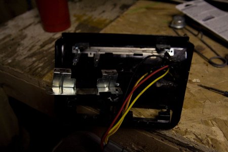

6. Make sure the connectors and wires are no longer attached to the rear bracket. Take the rear bracket in the channel locks or vise grips and heat it up. When it is hot, push it into the plastic of the console, making sure it is oriented correctly.
7. Once it is cool, let it sit for a moment and you should be able to do this:
8. Reinstall all of the harnesses and connectors, and reinstall the console by seating the rear of the unit flush with the roof, and push it forward until it stops and contacts the bracket on the roof. Install the screws and bulbs in the front. Reinstall the lenses, and test everything to make sure it works.
