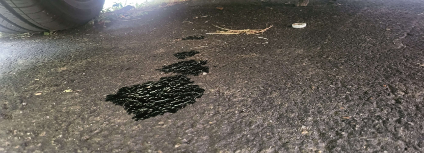

Hi, just wanted to update you on the results of this. So, I ended up figuring out, with the help of a mechanic friend, where to drill the weep hole, which I did, and quite a lot of gross black tar came out over the following day. Unsurprising, but while it helped, it did not fully fix my issues.

Some type of turbo failure my guess based on what you found and your smoke and boost issues. Shame you aren't looking at Error codes. Right now for me would just be guessing, clogged turbo oil inlet filter maybe. How frequent were oil changes, how many miles? Are u the first owner, some details about any major work performed?
If your oil doesn't change much the oil supply can clog the supply line, that is one uneducated guess. The intercooler having black oil, is post turbo and not a good sign of turbo health.
