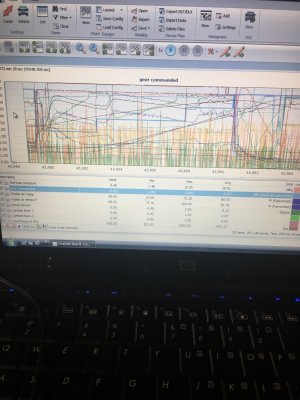

I have the log here what do I look for

Top of 5th but I'm also spraying on a # 6 625 ml nozzle 100% meth on ethanol blend. E27 what it took to get to 93 oct. but yes that makes a lot of sense seems like it didn't like it as much as a dig. As for 120 nah not up here at 5200 elevation definitely not on stock turbos

Throttle closing most likely... he probably has you looking at 4 pids for throttle... check out absolute..

Just sent him the logs... he is the only one that can straighten it out...

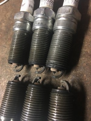

It's all good thanks did my plugs. Its all good until higher triple digits so that's jail anyways when I'm not in Mexico
That's with around 8k
