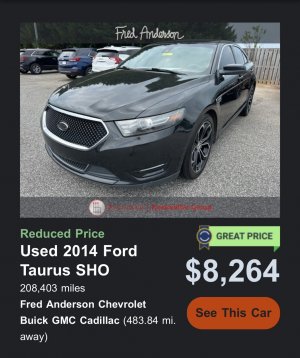

Saw this recently. 208,403 miles. I'd love to talk to the owner(s) to see what kind of maintenance issues they had over that mileage. What broke? What was replaced before it broke?
