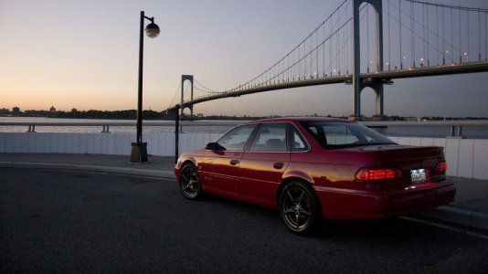

I love the LED taillights. They're friggin' awesome, and brighter than all get-out. A few words of caution, should you decide to get some, though:
Nite-shades will just make it look weird when lit. And not in a good way. I would recommend some other method of darkening the lens should you decide to do so.
They leak. Some of them leak in the seam between the two halves, requiring large amounts of RTV. Some of them actually leak where the plug goes. That took ages to figure out, and a lot of frustration; they look really bad with water pooled up at the bottom of the lens.
Other than that, install is pretty straight forward. For whatever reason, my '94 never showed the lamp out with them on. However, I'm beginning to think it never worked in the first place. My wife's 95 threw all sorts of lamp out warnings, but that's because that car has HID lamps and LED turn signals and parking lamps. It's insane.

IMG00083 20100715 1409
It's the only one I can find right now. I have other pictures, but those are of the clear version.
