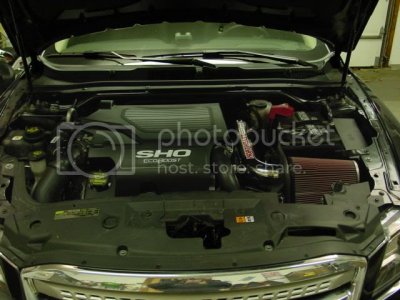

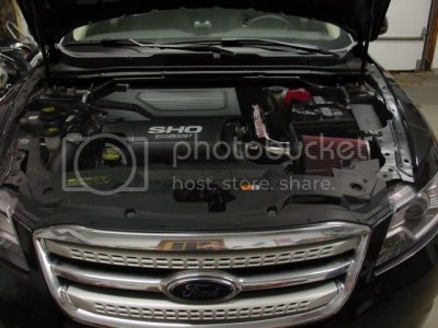

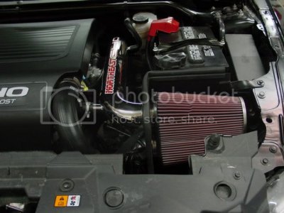

Well my Hennessey 60hp EcoBoost kit showed up Wednesday....:woo-hoo:
Kirk from Northeast SHO was going to help me install it this weekend but I couldn't wait and went ahead and installed it Wednesday night.
It took me about 4 hrs to install, getting the back blowoff valve hose off was the worst part. The factory clamps were pointing backward and it was tough getting to them to get them off.

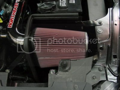

I did have some fitment issues with the kit though. With the tube bolted to were they tell you to put it there was no way I was getting the cold air box in and connecting the filter to the pipes..
So I did what I could and ran it without the box until today..
I went down to visit Kirk (Northeast SHO) today and he fixed the problems. A little moddifing, cutting, tweaking and she went together.

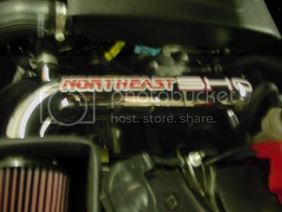

For anyone who buys this kit, if they are all the same which I expect they use some sort of jig so they all should be the same. Cut the tab off the main pipe before you do the install. With it bolted to where they put it the pipe will not reach the cold air box and it is to high. We also had to moddify around the back side of the box to make the filter fit. You will see in the pictures that we had to cut a little off the headlight support to get the filter in there with the box.
All in all I am pretty happy with the kit, fitment could have been a little better with the kit that I got but not to bad of a job..

Looks like it gets rid of that terrible 180 in the stock intake. Looks really good :).
Wait a second....does that CAI go right down to both turbos? :dribble:
hdmlnium
Dec 18, 2009
88
30
Maine
Yes the CAI connects to both turbos.. Hennessey did a good job with the kit all in all..

I'm really surprised they didn't use that little ram air area that had to be modified to fit. Then I see a gaping hole where it could have fit. When I made mine months ago, I incorporated that so-called ram air section with a little scoop myself. Really shocked at how small the air box itself is but the rest of the kit looks pretty damn cool. That larger filter looks like it'll suck in some air, hopefully not alot of that hot engine air though. And I'm liking the NESHO decal too. :dribble:

The kit is very cool! I was very interested in looking at the kit so I had Bill com down so we could do some testing, time never worked out to do the testing that we wanted but here is the best I can do on a write up/test and trying to be partial.
Fitment, well for one of the very first few that Hen has made I would give the direct bolt in a 6.. Things needed to me moved, removed, cut tweaked but its in there.. Bill was unable to get in the filter housing (black steel blocker plate) the one that "keeps the hot air out.. This can be left out anyway as it does not seal the filter off very good.. but I sure it will help.
The product in looks wise is 100% this thing looks great! and they put in a good amount of effort in making it.
The tubes are larger so they will flow more air, but the turbo connections neck down so Im not sure they are improving the airflow (kind of like the Gen 3 mufflers, they went to a 2.25 pipe but had a 1.75 neck down at the muffler) .. I did not measure the pipes but they look 2.25 but the turbos inlet is 2" or smaller..
I think I had roughly 3 hrs in installing the airbox part, which for a bolt in piece was a long time. I needed to used a chop off wheel it install it, on what I wont say but it was difficult. and could be done better in the future.
All in all a great looking piece and im sure with the tune and the exhaust it works. I don't think its worth all that money, I can tell you that.. but hey its way better that anything I or anyone else offer at the moment.
