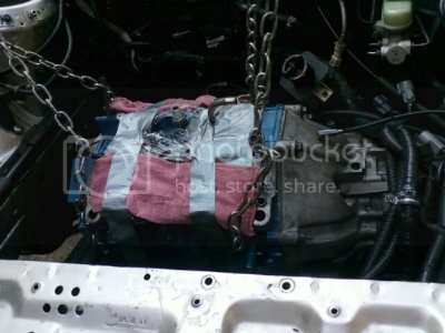

Just precautionary. I take out the radiator as well since the coolant is out anyway, hoses are disconnected, and is held on by only 4 bolts. When putting it back in, I put the block in minus the heads for the sake of having extra room to work with. Easier for me that way.

i take out the radiator ...... and fan to free up more room. I think I have a list of all connections that have to be disconnected .... ie the pwr steering elect connection .....the pwr steering pump hose ....... some other odds and ends ...... just need to get me a cherry picker and engine stand
