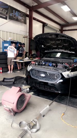

I’ve got a 2013 ford police interceptor and got stage 3 turbos, exhaust, CAI, MSD coils, thermostat and methanol. Just got done with tuning and dyno with 5star tuning and out down 468hp and 528tq on 93 octane. Got it set for 104 but need to get a bigger injection pump since the stock one can’t handle it.

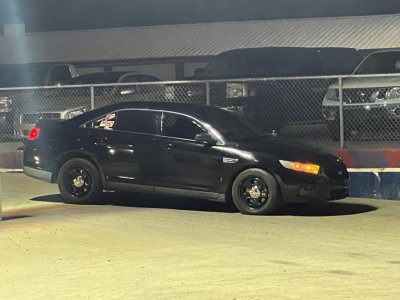

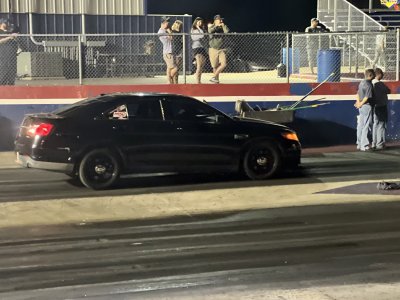

Thanks! Here is a few I have. I’ll try and upload some dyno videos and one of me at the drag strip last week.

I’m running 50/50 mixture and I am tuned for it by 5star tuning in Florence SC. They done all my tuning and got the most I can while I was in the dyno. When we went to 104 my pump couldn’t handle it and dropped down to 1300 psi. I’ve only got street tires that I’ve took to the track at the moment. I ran a 7.93 but at 90 mph. It was spinning bad and with that mph I should have been a 7.6ish
