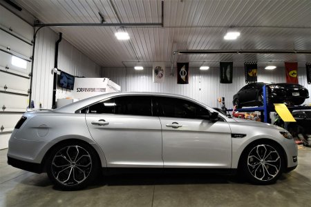

I finally did it, pulled the trigger on some new lowering springs to I don't make the car not handle such like a boat? but anywho the springs actually feel pretty good, just a bit bumpy, the car definitely handles alot better if im being honest, putting in some before and after pics down below!
