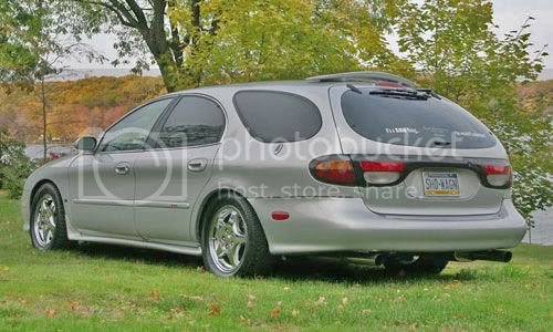

SHOALL ... when I saw your wagon, I thought for a moment it was a pic of mine.
I do like your wheels!
