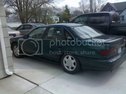

He is a quick pic as promised!
IMG 20110428 113409
Passenger side rear wheel well and the whole lower portion of the car has some cancer, but it was free and it is a lot cheaper to drive then my 05 Dodge Ram so I will have no problems living with it!

Wow, clean on the outside, but other than that, that is some serious rot going in if your cladding is falling off. I'd take a look underneath and see how much more rot is under there. It could get to a point of being unsafe.

if side skirts are falling off, that's not good at all. yep check under the car. My red SHO is very very bad like that. sides are that rusty, that the whole car i making noise , because a lot of metal points are not attached anymore. Also, One subframe bolt rusted so bad, that I can't take it off to replace mount and that plays a big role in handling. little bracket for e-brake cable is gone with the rot, and I don't have e-brake anymore. So, in reality, sometimes it is cheaper to give something away, then mess with it.

Ill take a good look under it tonight, it is going to be the first time I am going to have it up (figuring out a way to reattach the side skirt).

Well I have decided after looking under the car and giving the whole thing a good sweep, I am not putting a lot of money into the car. The rear tires are shot from the rubbing on the blown struts, the entire exhaust is worse then I thought, and the whole underside of the car is rather rusty from the wonderful Iowa winters.
