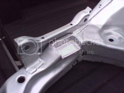

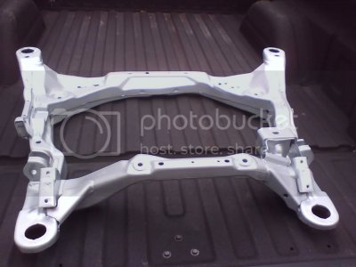

You need to cut and weld the motor mount mounting locations as well as the tranny mount location you also need to cut a notch and re weld in the hole. You would also need to make sure you have them re welded in the right spots or things wont line up.
This is what mine looked like prior to installation.

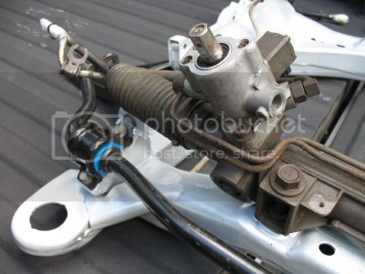

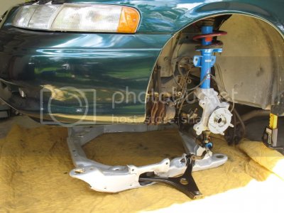

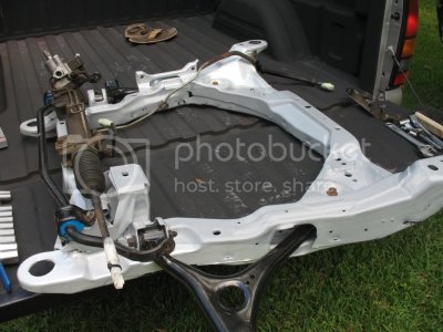

You'll need a jig to get the mounts in the right place. With the ZF rack, you'll need custom power steering hoses. I combined a Gen 2 hose with a Gen 3 hose for the high pressure side, and used a Gen 3 return to route the low pressure hose under the AC condenser. You'll also need to figure out some way to mount the cruise control, which I haven't done yet. I just have it wedged in between the trans and frame for now. You'll need longer caliper bolts, and I used Gen 3 ABS sensors. Here's mine before installation.

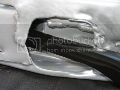

BTW, I had to do some grinding where the control arm goes into the frame under the trans mount.
