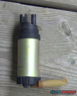

Total length from top of connector (or fuel output ******) to feets on the bottom boot is 5 & 1/8".
Diameter of the pump body is 1 & 1/2"
Sock on the bottom extends 2" from the pump body.
Fuel pump on side

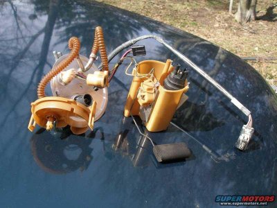

Fuel pump module opened

In that last pic the pump should be on the other side of the module when installed.....
