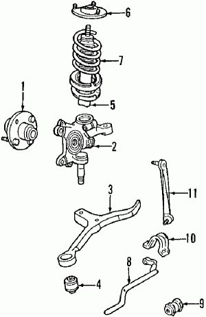

Apparently the change came at 5/98. Part 4 is the front bushing and part 9 is the rear bushing.
The bushings are available OEM and I have found the rear bushing in MOOGs catalog as part number K8415. But Moog list this for all Taurus and Ford has a special rear bushing part for the SHO.
Front suspension exploded

If my experience collecting parts for my '91-to-Gen3-subframe swap is any guideline, part #9 in that illustration is a swaybar bushing, not a control-arm bushing.

You may be right. But there is a bushing that is not in this picture then. It is on the other end of the #3 part.

I also was pretty sure that illustration was showing a swaybar bushing. This may go back to why I told that the rear a-arm bushing was only available with a new arm. I just checked my Mitchell and MicroCat databases, and neither show a P/N for the rear bushing.
