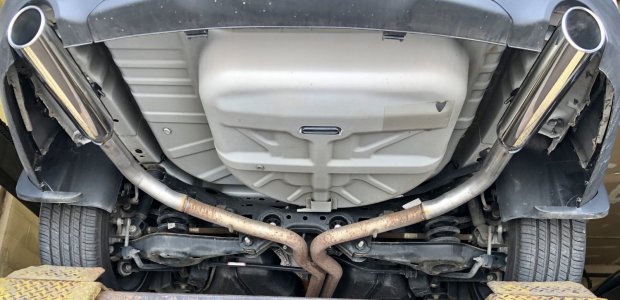

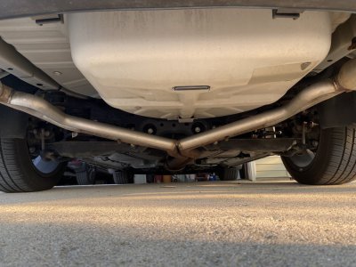

I just wanted to thank this thread and SilverSHO for saving my exhaust. I performed a muffler delete and certain times it was really bad but I loved WOT. I just happen to work for a tube fabricator. Went with a little different setup, didn’t drop the exhaust to install. Really helpful thread. There is a before and after pic 4193688E D79A 4BEC BE4E 9F653E6A35B4
5B2BFD43 BCE3 4F30 AB01 EBF731CDC3C6
Not nearly as neat as others but now sounds great at all times to me. Thanks again.
