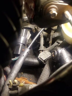

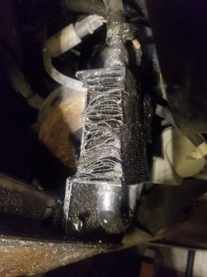

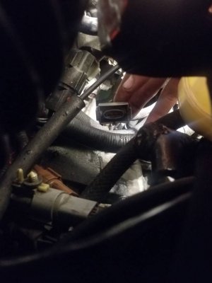

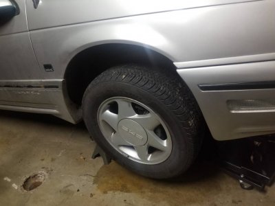

Here are a couple pictures (car is on jacks). Last owner put a Accel #140035 distributor on it. Found a plug hanging to the right oh the water pump and below the intake boot not sure what it goes to. Im in no rush for any suspension work but it is something that will be done. Im only 18 so not alot of experince but I have some backround in engines. Thought you might want to see the oil cooler too haha. 344c04855d604c417910a7745cb79fb17edf341abb59a3b9c03acc0ee0f933204c523a9636fb10960039b44143926e00B9540c4b5efcf11031c1db75e20f52922407e2238135b3ff7fffcd2953841885D74b377ec448fc74bd86afbd4feb604b9d8e7e069d5093b448331a75c731204dD1fe9b6bb3a77f66925a2c902e55b372

Aluminum subframe bushings are good. That's the power steering cooler, if I had to guess, the rubber lines are hard and are leaking where they go onto the cooler, the clamp looks suspect. The plug to nothing is normal, I believe its for EGR on California cars. The stock coil is sufficient, I'd put a used one on before an Accel.

good to know thank you! could be the reason for the pitch black steering fluid

Is the fluid level good? Free of grit? I would extract it and store it in a clear glass or oil resistant container. Add new fluid back in, rinse repeat at least 3 times. Then evaluate from there. Could be the fluid was never replaced, there is a leak, or wear in the gear.
If after some time the new fluid looks good and steering feel improves, probably good 2 go for a while. I would send in the old steering fluid to Blackstone Labs for analysis to make sure the gear is good.
